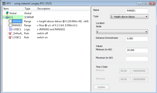

The RTC is defined by adding components to a pump regulator in the RTC Window Editor.

RANGE 1 |
Range type: Z - height above datumLocation node: KMinimum: 20Maximum: |
TRUE if water level at node K is greater than or equal to 20 mAD |

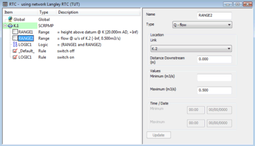

RANGE 2 |
Range type: Q - flowLocation link: K.2Minimum: Maximum: 0.5 |
TRUE if flow in conduit K.2 is less than 0.5 m3/s |

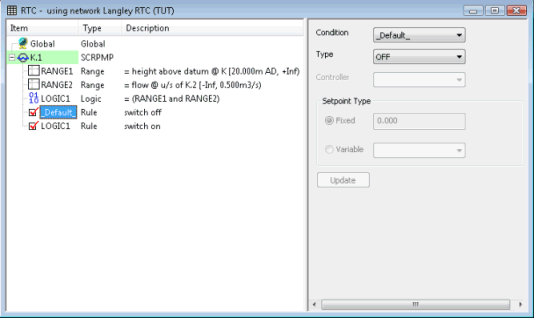

RULE 1
Condition: _default_Rule type: OFF |
Default status of pump is OFF |
RULE 2 |
Condition: LOGIC 1Rule type: ON |
Switch on pump if LOGIC 1 is TRUE |
