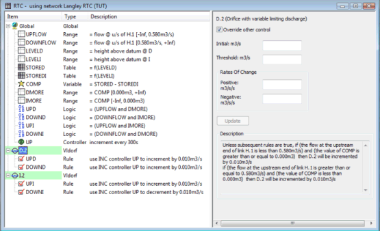

The RTC Window Editor is used to view and edit the Real Time Control of regulator structures, such as pumps, sluice gates and weirs in the network.
The editor is opened by selecting Grid windows
RTC editor from the Window menu.
Real Time Control (RTC) allows the the state of ancillary regulator structures, such as pumps, sluice gates and weirs, to be changed according to the state of sensors elsewhere in the network and thus control flows throughout the system.
RTC can also be edited in a grid editor opened by holding down CTRL while selecting Grid windows
The left-hand pane of the window gives a representation of an RTC object; the right-hand pane varies depending on which element of the RTC object has been selected.
A scenario contains one or more regulators. Under each regulator, the following components can be added:
Components can also be inserted under the Global object. These components can be used by any of the regulators in the scenario.
