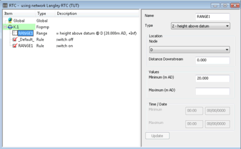

RANGE 1
Range type: Z - height above datum
Location node: DMinimum: 20 mMaximum:
TRUE if level at node D is greater than or equal to 20 mAD

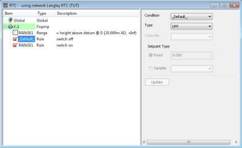

RULE 1
Condition: _default_
Rule type: OFF
Default status of pump is OFF

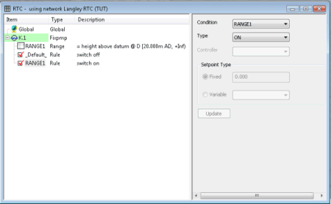

RULE 2
Condition: RANGE 1Rule type: ON
Switch pump ON if RANGE 1 is TRUE
  1. Range 1: Defines Node D as the control point with a minimum value of 20 m
  2. Rule 1: Unless subsequent rules are TRUE, the pump will be set to the default status of OFF
  3. Rule 2: Switches the pump ON if the level at node D is at or above 20 m
