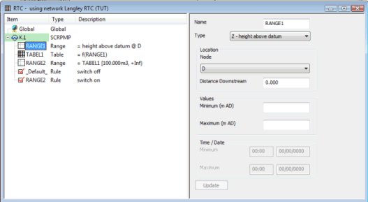

The RTC is defined by adding components to a valve regulator in the RTC Window Editor.

RANGE 1 |
Range type: Z - Height above datum Location node: D Minimum: Maximum: |
TRUE if height above datum is between - / + infinity |

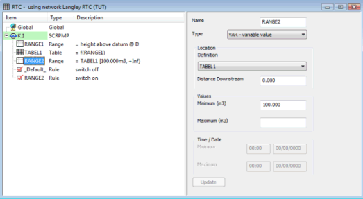

RANGE 2 |
Range type: Variable Location Definition: TABLE 1 Minimum: 100m3 Maximum: |
TRUE if volume is greater than or equal to 100 m3 |

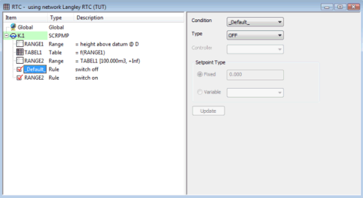

RULE 1 |
Condition: _default_ Rule type: OFF |
DEFAULT status of pump is OFF |

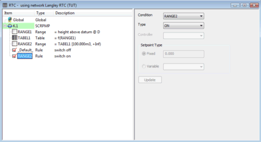

RULE 2 |
Condition: RANGE 2Rule type: ON |
Switch pump ON if RANGE 2 is TRUE |
