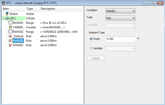

The following example models controlling the status of a sluice gate, by applying a time delay in order to close the sluice gate 40 minutes after it has been opened.
In this example, a variable is used as a timer. The timer starts when the sluice gate is opened. Once the timer has reached 40 minutes, the gate is closed.
The example is defined by adding components to a sluice gate regulator in the RTC Window Editor.
Component |
Parameters |
Effect |

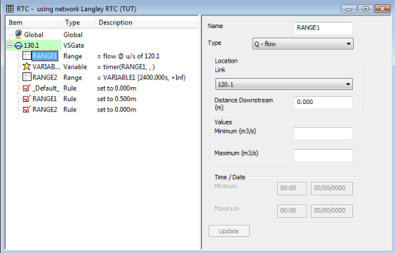

RANGE 1 |
Range type: Q - flow Location link: 120.1 Distance Downstream: 0m Minimum: Maximum: |
TRUE if flow in conduit 120.1 is between +/- infinity |
VARIABLE 1 |
Measurement: Time Operator: Timer Start: RANGE 1 |
Start Timer when RANGE 1 becomes TRUE |

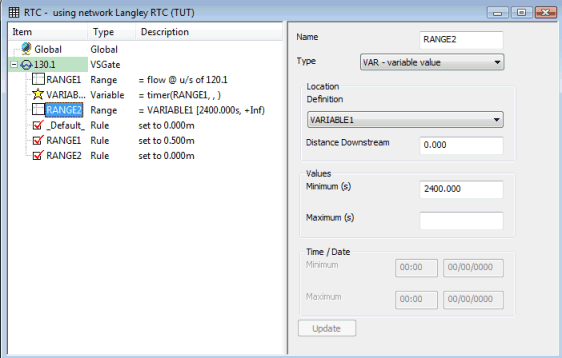

RANGE 2 |
Range type: Variable Location definition: VARIABLE 1 Minimum: 2400 s Maximum: |
TRUE if VARIABLE 1 is greater than 2400s |

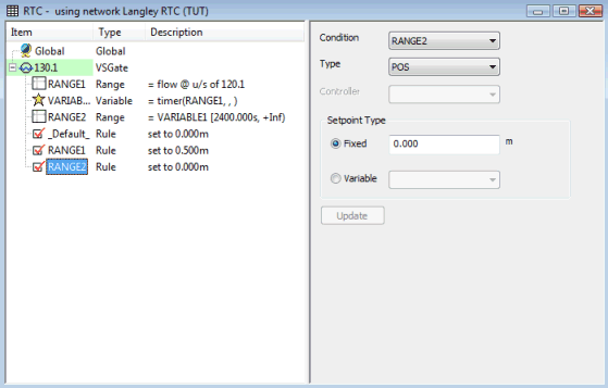

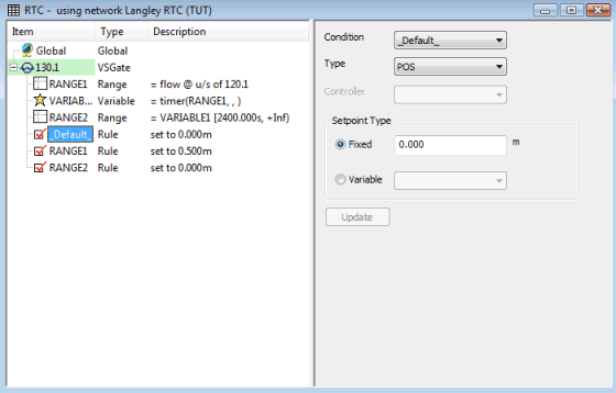

RULE 1 |
Condition: _default_ Rule type: POS Setpoint Type: FIXED 0.000 m |
DEFAULT status of gate is Closed |
RULE 2 |
Condition: RANGE 1 Rule type: POS Setpoint Type: FIXED 0.500 m |
Set sluice gate to 0.5 m if RANGE 1 is TRUE |
RULE 3 |
Condition: RANGE 2Rule type: POS Setpoint type: FIXED 0.000 m |
Set sluice gate to 0.0 m if RANGE 2 is TRUE

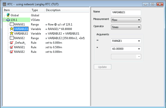

The following example models controlling the operation of a sluice gate, by measurement of the total flow through a conduit. When the total flow in the conduit reaches a given volume, the sluice gate will be closed.
In this example, a variable is used to convert the flow measured in the control conduit to a cumulative flow over a timestep. A second variable is used to keep a total of the cumulative flow.
Component |
Parameters |
Effect |

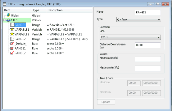

RANGE 1 |
Range type: Q - flow Location link: 120.1 Minimum: Maximum: |
TRUE if flow is between - / + infinity |
VARIABLE 1 |
Measurement: Flow Operator: Times Argument 1: RANGE 1 Argument 2: Constant = 60 |
Equals RANGE 1 flow multiplied by 60 |

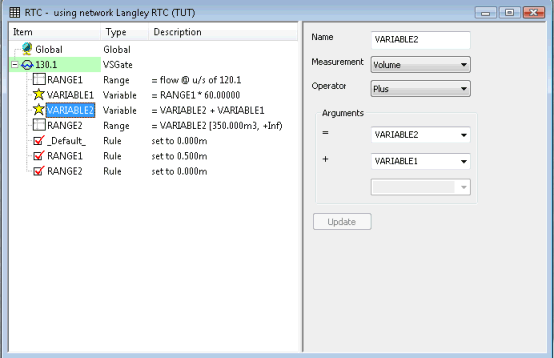

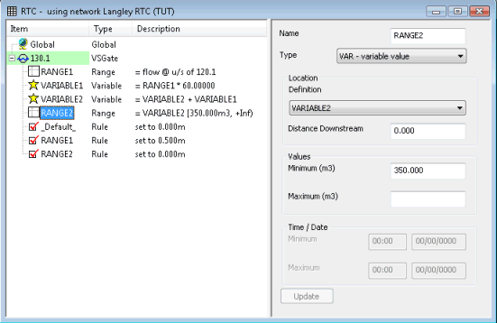

VARIABLE 2 |
Measurement: Volume Operator: Plus Argument 1: VARIABLE 2 Argument 2: VARIABLE 1 |
Equals VARIABLE 1 + VARIABLE 2 |
RANGE 2 |
Range type: Variable Location definition: VARIABLE 2 Minimum: 350 m3 Maximum: |
TRUE if VARIABLE 2 is greater than or equal to 350 m3 |

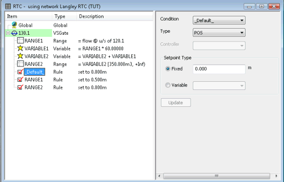

RULE 1 |
DEFAULT status of sluice gate is 0.0 m |

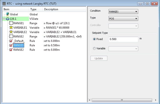

RULE 2 |

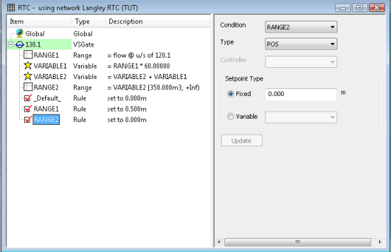

RULE 3 |
