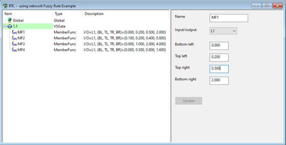

A set of membership functions can be defined for each input and output of the fuzzy logic control algorithm. Each definition has 4 parameters defining a trapezoidal (or triangular) probability function.
The Member functions pane contains the following fields:
| Name | The name of this input/output function. This must be unique for this input/out function for the current regulator. |
| Input/output |
The choices are:
| Bottom left | The bottom left value of the trapezoidal probability function for the selected Input/output type. |
| Top left |
The top left value of the trapezoidal probability function for the selected Input/output type. This value must be greater than the Bottom left one, and must not exceed the Top right one. |
| Top right |
The bottom right value of the trapezoidal probability function for the selected Input/output type. This value must be greater than Bottom right one. |
| Bottom right |
The bottom right value of the trapezoidal probability function for the selected Input/output type. This value must be greater to the Bottom left one. |
