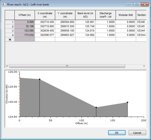

River Reach - Left river bank editor
Offset (cross chainage) values are automatically calculated from X and Y coordinates, but are not exported or imported when exporting to / importing from external files.
When viewing Bridge or River Reach data:
To insert or delete rows in the section points grid, right click on the left hand column of a row to display the context menu. The options available are:
When editing River Reach or Bridge section data and Cross Section or Bank line data the following options are also available:
Edit Offset - display the Edit Offset dialog. Enter an offset value between the offset values of adjacent vertices and click OK. The offset of the point clicked on will be adjusted. X coordinate and Y coordinate values of the vertex will be calculated from distance from adjacent vertices, whilst maintaining the original offsets of the adjacent vertices.
For line ABCDE, a new offset is specified for vertex C (shown as C'). The position of C' is calculated by finding the point that is distance BC' from vertex B and BC+CD-BC' from vertex D. |

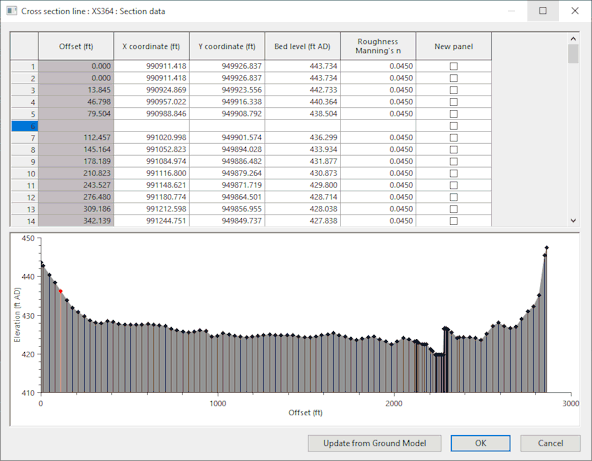

When editing Cross Section or Bank line data further additional options are available:
A graph of the profile of the currently selected section is displayed at the bottom of the editor.
When viewing Bridge or River Reach data; selecting points on the graph will temporarily highlight section vertices on the GeoPlan by drawing a small box round the selected vertices.
Right-click on the graph to display a context menu that includes options that allow different properties of the graph to be turned on or off.
If a ground model is loaded onto the GeoPlan Window, a trace displaying the ground model elevation can be displayed.
If results are loaded onto the GeoPlan Window, a trace displaying the water level at the current timestep will be displayed.
This button is only available when editing section data for a Cross Section line.
Cross section line editor
When you click Update from Ground Model,and a ground model is loaded on the GeoPlan, the cross section data is automatically updated with levels from a ground model, and an Update from Ground Model Report is displayed. A message is displayed if a ground model is not loaded.
