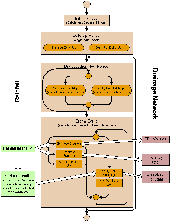

The diagram below describes the operation of the Surface Pollutant Model as part of a simulation.
Inputs to the model are down the left hand side of the diagram. Output to the drainage network is shown down the right hand side.
In the main boxes, the surface sediment process is on the left and the gully pot pollutant process on the right.
Schematic diagram of the Surface Pollutant Model during simulation

Rainfall inputs
Rainfall on the catchment surface drives the process of sediment washoff and gully pot flushing.
Rainfall intensity is used to calculate the initial erosion of sediment from the catchment surface, and the potency factors of any pollutants attached to that sediment.
A value for surface runoff is then used to calculate the rate at which eroded sediment is washed into the network, and the rate at which dissolved pollutant is flushed from gully pots.
Unfortunately, for historical reasons, different runoff calculations are used for each of these processes:
Storm event
Surface erosion and Gully Pot flushing calculations effectively take place in parallel because the two parts of the model are completely independent.
For more information, see Surface Washoff and Gully Pot Flushing.
Surface erosion
The three parts of the surface sediment calculation take place in parallel. They all use the initial sediment mass at the start of the timestep.
Surface erosion and the potency of attached pollutants are calculated using the rainfall intensity.
All the sediment washed off the surface is treated as Sediment Fraction 1.
The rate at which eroded sediment runs off into the system is calculated using the runoff model chosen for the hydraulic calculations.
The calculations use the runoff from Runoff Surface 1 and Runoff Surface 2 defined in the Land Use Definition. By convention these are both impervious surfaces - Runoff Surface 1 is the road surface and Runoff Surface 2 is the roof area.
Surface build-up continues during storm events and the build-up is calculated in the same way as during dry weather periods.
Gully pot flushing
The amount of pollutant flushed out of gully pots is calculated using a value for surface runoff.
The calculations use the runoff from Runoff Surface 1 defined in the Land Use Definition. By convention, Runoff Surface 1 is the road surface.
The runoff is calculated by the hydraulic engine using the runoff model you selected for hydraulic calculations.
After the gully pot flushing calculation, the software calculates the amount of build-up in gully pots. The calculation is the same as that used during dry weather periods.
