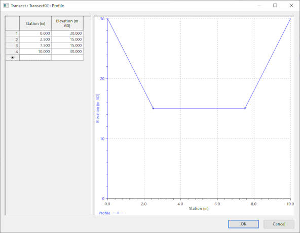

The Transect Editor is displayed when the
button is selected in the Profile field in a
Transect, and is used to specify the station (the distance from the left bank) and the elevation values which define the cross section of a custom shape type of
conduit. The specified values will appear as the cross section profile in the graph.
| Item | Description |
| Grid / Graph |
The station and elevation values entered in the grid will appear as the cross section profile in the graph. See the Transect Data Fields (SWMM) for further information. |
| OK | Saves any changes to the values in the grid and closes the editor. |
| Cancel | Discards any changes to the grid values and closes the editor. |
See Creating User-defined Shapes (SWMM) for information about using the editor to create shape curves.
