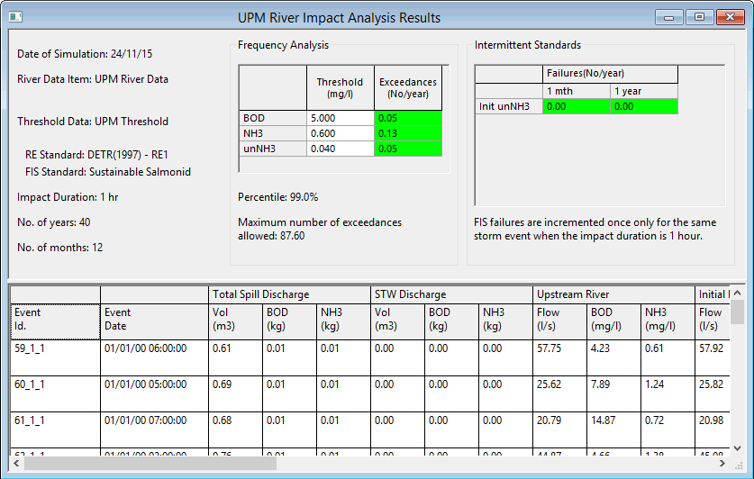

The UPM River Impact Analysis Results view displays a report containing the spills table and river impact assessment table.
The view is displayed when you click on Produce Reports on the UPM River Impact Assessment dialog.
The block of fields in the top left-hand corner of the report show:
The Frequency Analysis table shows the thresholds set for BOD, total ammonia (NH3) and un-ionised ammonia (unNH3). (See UPM Threshold Data - River Ecosystems View.) For each of these, the table shows the number of exceedances per year occurring during the test. The table cells are coloured green if the number of exceedances is acceptable or red if it is not. You can change the thresholds in the table, and the number of exceedances will be recalculated.
The maximum number of exceedances is shown at the bottom of the table.
The Intermittent Standards table shows the number of occasions per year that concentrations of initial un-ionised ammonia (Init unNH3), downstream dissolved oxygen (DS DO) and downstream un-ionised ammonia (DS unNH3) have exceeded the values set in the Fundamental Standards view. There is one column for each Return Period selected in the UPM River Impact Assessment dialog. The table cells are coloured green if the number of failures is acceptable or red if it is not.
