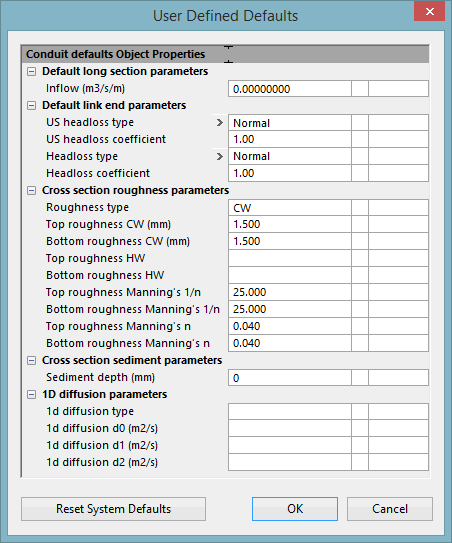

You can view and change a number of network object defaults and global parameters via a User Defined Defaults dialog.
The dialog is displayed when you choose an option from the User defined defaults submenu of the Network menu, and then select one of the following options:
The dialog allows you to view and edit default values for the selected network object. When the object uses the #D (default) flag for one of the fields listed below in the appropriate section, the default value entered here will be used. Making changes on this window and clicking OK will update network objects using the #D (default) flag if appropriate.
Click on the Reset System Defaults button to reset the default parameters to the original system defaults.
These defaults are applied if you set the #D (default) flag for any data field that has a default.
The underlying system defaults are NOT used when a field on the user defined defaults dialog is left blank. The blank value is treated as the default. In all places where this field has the #D (default) flag the field will be set blank. If it is not valid for the field to be blank the cell will be coloured pink, indicating that a value is required. You will also see errors when you validate the network.
Underlying system default values are shown in the tables below using InfoWorks ICM native units. If you have selected different units for the field, the default value displayed will be different. The current units are shown in the field title.
The Conduit Defaults dialog allows you to view and edit the following information:
Database Table Name: hw_conduit_defaults
Field Name |
Help Text |
Database Field |
Size |
Precision |
Default |
Error Lower Limit |
Error Upper Limit |
Warning Lower Limit |
Warning Upper Limit |
Inflow |
The inflow distributed according to the conduit length. For example, a value of 0.00001 m3s-1m-1 sets an inflow of 0.00123 m3s-1 for a 123 metre long conduit.
inflow |
Double |
CI |
8 |
0 |
0 |
0 |
US Headloss Type |
The default headloss condition at the upstream end of the link. InfoWorks ICM provides built-in headloss type options, or a user defined headloss curve may be defined. See the Headloss Curves topic for further information on the headloss type options:
us_headloss_type |
Text |
64 |
0 |
Normal |
US Headloss Coefficient |
The default multiplying factor for the standard headloss coefficient to represent additional losses due to bends or bad construction causing extra headloss. The list below shows some recommended values.
us_headloss_coeff |
Double |
2 |
1 |
0 |
Headloss Type |
see Upstream Headloss Type |
ds_headloss_type |
Text |
64 |
0 |
Normal |
Headloss Coefficent |
see Upstream Headloss Coefficient |
ds_headloss_coeff |
Double |
2 |
1 |
0 |
Roughness Type |
Choose either CW (Colebrook-White) or Manning equations for hydraulic roughness.
roughness_type |
Text |
7 |
0 |
CW |
Top Roughness CW |
The default roughness value for the top two-thirds of the conduit. |
top_roughness_CW |
Double |
RCW |
3 |
1.5 |
0.1 |
999 |
Bottom Roughness CW |
The default roughness value for the bottom third of the conduit. You must enter a value here. This value acts as the default roughness for the whole conduit if you do not give a value for the top two-third |
bottom_roughness_CW |
Double |
RCW |
3 |
1.5 |
0.1 |
999 |
Top Roughness HW |
top_roughness_HW |
Double |
3 |
20 |
5000 |
50 |
200 |
Bottom Roughness HW |
bottom_roughness_HW |
Double |
3 |
20 |
5000 |
50 |
200 |
Top Roughness Manning's 1/n |
top_roughness_Manning |
Double |
3 |
25 |
0.001 |
999 |
Bottom Roughness Manning's 1/n |
bottom_roughness_Manning |
Double |
3 |
25 |
0.001 |
999 |
| Top Roughness Manning's n |
top_roughness_N | Double | 3 | 0.04 | 0.001 | 999 | |||||||||||||||||||
| Bottom Roughness Manning's n | The default roughness value for the bottom third of the conduit. You must enter a value here. This value acts as the default roughness for the whole conduit if you do not give a value for the top two-third | bottom_roughness_N | Double | 3 | 0.04 | 0.001 | 999 | |||||||||||||||||||
Sediment Depth |
The default depth of permanent, consolidated sediment in the conduit. Note that the transport of this sediment through the system is not modelled. |
sediment_depth |
Double |
PS |
0 |
0 |
0 |
1D diffusion type |
Relevant to Water Quality Simulations only.
Default type of 1d diffusion can be set to either River or Estuary. Set to Estuary to calculate a diffusion coefficient that varies with tidal discharge and/or the longitudinal salinity gradient, or set to River to calculate a diffusion coefficient that is related to shear velocity. Used for 1D diffusion water quality simulations only. |
diff1_type_cont |
Text | 8 | River | |||||||||||||||||||||
| 1D diffusion d0 |
If 1D diffusion type is set to:
The value of d0 must be ≥0 (m2/s). Used for 1D diffusion water quality simulations only. |
diff1_d0_cont |
Text | DC | 8 | 0 | ||||||||||||||||||||
1D diffusion d1 |
The value of d1 must be ≥0 for rivers or ≥ 0 1/m for estuaries. Used for 1D diffusion water quality simulations only. |
diff1_d1_cont |
Text | 8 |
0 |
| 1D diffusion d2 |
d2 is a constant which determines the effect of salinity gradient on dispersion. The value of d2 must be ≥0 m6/(kg/s). Used for 1D diffusion water quality simulations only. |
diff1_d2_cont |
Text | 8 | 0 |

The value of d0 must be ≥0 m2/s. Used for 1D diffusion water quality simulations only. |
diff1_d0_cont |
Text | DC | 8 | 10 | |||||||||||||||||
1D diffusion d1 |
The value of d1 must be ≥0 for rivers or ≥0 1/m for estuaries. Used for 1D diffusion water quality simulations only. |
diff1_d1_cont |
Text | 8 | 10 | ||||||||||||||||||
| 1D diffusion d2 |
diff1_d2_cont |
Text | 8 | 0.0001 |
