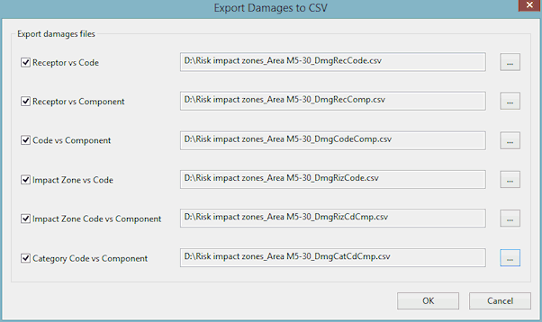

This dialog is used to export damage calculation results from Risk Analysis Simulations to CSV format.
It is displayed when you right-click a
Risk Analysis Simulation and select Export
to CSV from the context menu.
| Item | Description |
| Receptor vs Code | If checked, exports the table of damage values tabulated by Damage Receptor ID against damage function code. |
| Receptor vs Component | If checked, exports the table of damage values tabulated by Damage Receptor ID against damage function component. |
| Code vs Component | If checked, exports the table of damage values tabulated by damage function code against damage function component. |
| Impact Zone vs Code | If checked, exports damage values per risk impact zone category tabulated by risk impact zone ID against damage function code. |
| Impact Zone Code vs Component | If checked, exports damage values per risk impact zone tabulated by damage function code against damage function component. |
| Category Code vs Component | If checked, exports damage values per risk impact zone category tabulated by damage function code against damage function component. |
Browses for a location to save the exported CSV files to. |
| OK | Exports the selected files, in CSV format, to the chosen locations. |
| Cancel | Cancels the export operation. |
