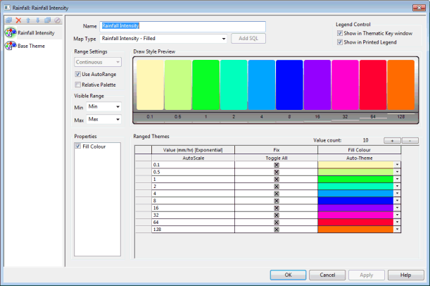

  4. Click Edit in the Theme column for the Rainfall object layer. The Layer Theme Editor is displayed:
  5. The default rainfall theme is called Rainfall Intensity. It is based on rain intensity and the default Map Type is Filled but other types are also available (see table below). Fill contours of rain intensity values have been auto-themed so the Draw Style Preview displays a set of colours as shown in the image above.
  6. You can use the default parameters or set up your own as required and click OK to commit your changes. See the Rainfall Theme Data Fields table below.

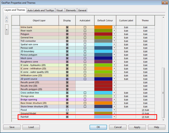

  7. Turn on the theme display by checking the Display check box for the Rainfall object layer in the Layers and Themes tab of the GeoPlan Properties dialog.
  8. Layers and Themes tab of the GeoPlan Properties dialog

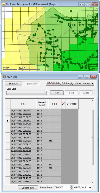

  12. Select different rows in the Time Series Data grid and observe the colour changes in the Rainfall theme on the GeoPlan.
