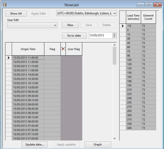

A Spatial Time Series Data object (Spatial Time Series Database icon) is used for storing spatial time varying data (TVD) that comes from external data sources. It can be used in simulations for InfoWorks and SWMM networks.
TSDB
An example of a configured spatial TSD
For an in-depth description of the data and options available for this object, see the Time Series Data Grid topic.
Working with Spatial TSD objects, opening or deleting historical versions of Spatial TSD objects
See the Time Series Data Objects topic for further details.
To configure a Spatial TSD object
  1. Create a new Spatial TSD database item.
  2. Drag the spatial TSD object from the Explorer window and drop it onto the GeoPlan or the main window.
    The Spatial time series data configuration dialog is displayed.
  3. Configure the import as appropriate (See the Spatial time series data configuration dialog for more information).
  4. When finished, click OK.
  5. The Time Series Data grid is displayed.
