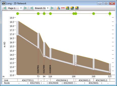

What is the Long Section Window?
The Long Section Window displays a cross-section through the length of a selected run of network objects. There are options for changing the way in which the long section is viewed and altering the labels that are displayed.
You can have several Long Section Windows open at the same time. Each Long Section Window may have multiple pages.
For Long Section Windows containing multiple pages, the page number will appear in the toolbar. Use the Next ( ) and Previous () arrow buttons of the toolbar to scroll through the pages.
If a branch is displayed in the Long Section Window, the branch number will also appear in the toolbar. Use the Next ( ) and Previous () arrow buttons to scroll through branches in order of branch number.

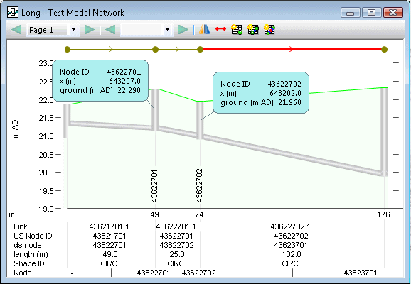

The Section Properties Dialog allows you to decide what grid labels are displayed along the x-axis and how network parameters are represented in the view.
Custom Labels may be added to the view by use of the Label tool .
