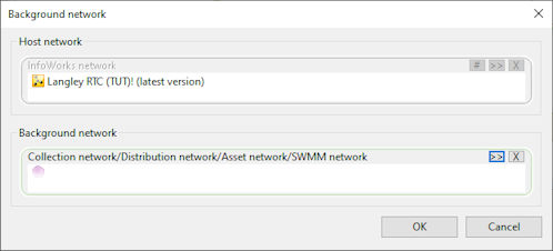

Background Network Dialog
This dialog is used to select a SWMM or InfoWorks network or, for on-premise databases only, an InfoAsset Manager network to be displayed as a background network on the GeoPlan window in conjunction with the host network (the network currently open on the GeoPlan). Previously committed versions of the background network may be selected for display.
If the background network is an ICM SWMM or InfoWorks network or, for on-premise databases only, an InfoAsset Manager Collection network, it can then be used to update the network.
A background network can also be loaded into the GeoPlan by dragging the network from the Explorer Window tree into the GeoPlan window. However, this will only display the latest version of the network; it is not possible to select a previous version in this way.
To open the dialog, select Background network from the Network menu.
The current network will be displayed in the Host network section of the dialog. Browse for a background network in the current database or drag in a network from a Guest Database.
