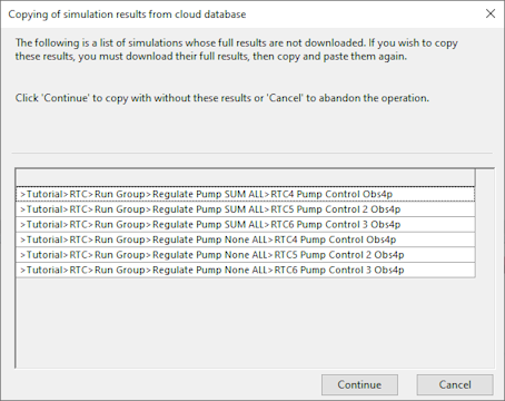

Copying of Simulation Results from Cloud Database Dialog
This dialog is displayed when you have checked the Copy simulation results box in the Copying of Simulation Results, Ground Models and Time Series Data dialog and the simulations you copied are from a cloud database whose results are either not downloaded or are Summary results.
Tip: You can only paste simulations whose full results have been downloaded.
It lists all the simulations that don't have full results downloaded, and gives you the option to cancel the paste (so you can download them) or continue without copying the simulations.
