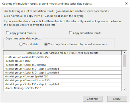

Copying of Simulation Results, Ground Models and Time Series Databases Dialog
Example of dialog when an item containing one or more simulations, ground models and time series data objects is being copied.

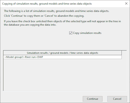

Copying of Simulation Results Dialog
Example of dialog when an item containing one simulation is being copied (no ground models or time series data objects)

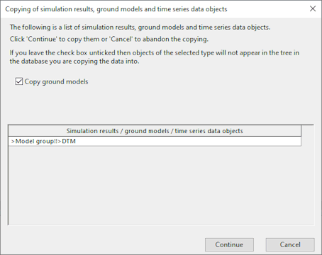

Example of dialog when an item containing one ground model is being copied (no simulations or time series data objects)

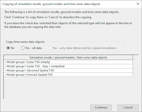

Copying of Time Series Databases Dialog
Example of dialog when only time series data objects are being copied (no simulations or ground models)

Copy ground models
Available when at least one ground model is included in the item(s) being copied.
Because ground models are potentially very large, you can exclude these files when making the copy by ensuring the box is unchecked.
Copy simulation results
Available when at least one simulation is included in the item(s) being copied.
Because results files are potentially very large, you can exclude these files when making the copy by ensuring the box is unchecked.
Note: The box is disabled when copying simulation results from:
  • A cloud database to a transportable, if the database version for the transportable is earlier than 2024.5.
  • An on-premise to a cloud database.
  • A cloud to another cloud database.
Copy time series data
Available when at least one time series data object is included in the item(s) being copied.
The following options are available:
  • No - Ignore time series data objects when making the copy.
    Enabled when items to be copied do not contain any simulations.
  • Yes - all data - Copy all the time series data objects present in the item to be copied, regardless of whether they are used in the simulations to be copied.
  • Yes - only data referenced by copied simulations - Restrict the copying to the time series data objects used in the copied simulations.
    Enabled when items to be copied contain at least one simulation.
Note: These options are currently disabled when copying TSD data from a cloud database.
Sim / Ground Model / TSD grid
This grid lists the simulation results, ground model and time series data objects present in the items to be copied. These are the objects you need to make a decision about and decide whether they should be copied.
