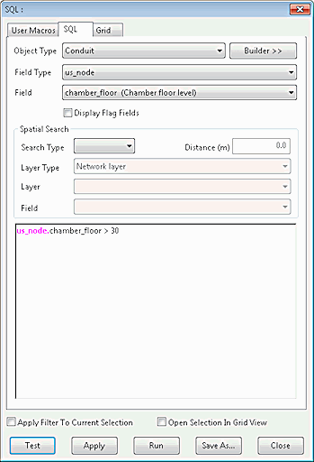

Example 1 Example
The very simple example below shows a query to select pipes that are connected to an upstream node with chamber floor greater than 30.

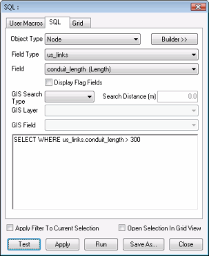

Example 2 Example
The example below shows a query to select nodes that are connected to an upstream conduit object with length greater than 300.
A node will be selected if the query is true for any of its upstream links.

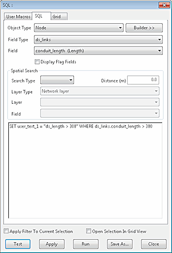

Example 3 Example
The example below shows a query to update the User Text 1 field of nodes that are connected to an upstream conduit object with length greater than 300.
