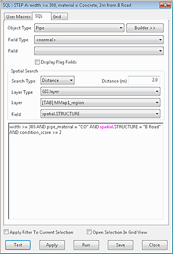

  4. To include a field in the spatial layer search, select the field in the Field box, or enter directly into the edit box using the syntax shown in Figure 1 where the field name is included in the query - spatial.STRUCTURE
  5. Use the spatial fields in the query in exactly the same way as network object fields
Click on the image below to show an example which uses GIS data to find damaged concrete pipes at least 300 mm in diameter that lie within 2 metres of a minor road.
Example
GIS Search Example

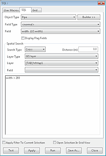

Note: If both spatial search select options and object type select options are defined in the query, the spatial search is carried out first. The main query using object type criteria is then carried out on the results of the spatial search.
For example:
This query will:
  1. Search for any pipes crossing any object in the layer 'MMap1'.
  2. From the set of objects found in step 1, pipes with a width greater than 200 will be selected.
