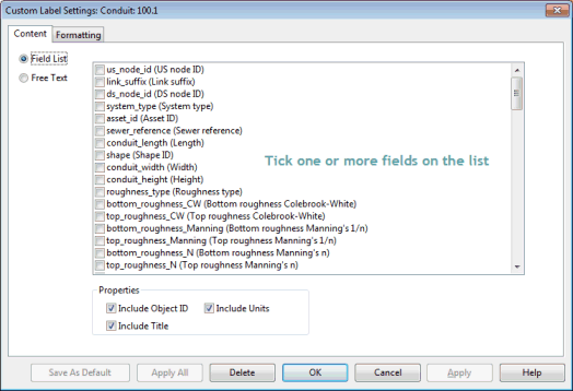

Field list
This option is selected by default and allows the user to select data fields to be displayed on the labels from a list to the right. (Note that SQL expressions created via the Layer Theme Editor will also be available in the right list.)
Additional properties can be selected in the dialog:

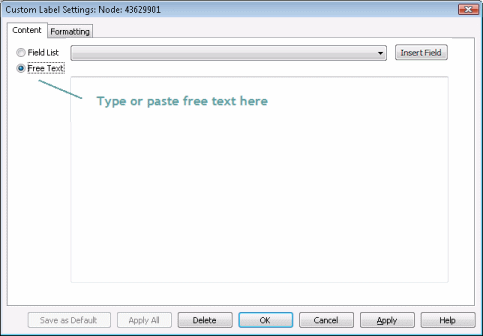

Free text
This option allows the user to type or paste one or multiple lines of text as label on the text box.
Values of object fields can also be included.
Entering an object database field name of within curly brackets will display the value of the field when the label is attached to an appropriate network object. Type the field name into the text box directly, or select the field from the dropdown list and click Insert Field to insert the field name into the text box. (Details of database field names can be found in the Network Data Fields topics.

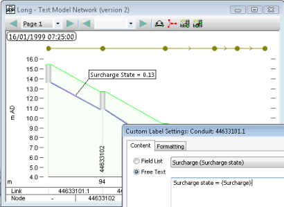

Example in InfoWorks ICM of a Long Section Window with an object database field name specified as free text

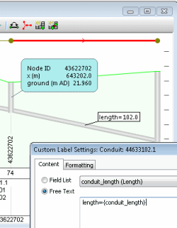

Similarly, if results are loaded in the GeoPlan, entering an object results field name within curly brackets (e.g. Minimum Pressure = {pressure}), will display the results value of that field when the label is attached to an appropriate network object.
Results field names are listed after the user fields in the Insert Field dropdown.
