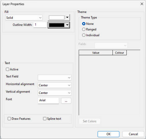

ArcGIS Maps, ArcGIS Engine, and ArcGIS Desktop Layer Properties dialog

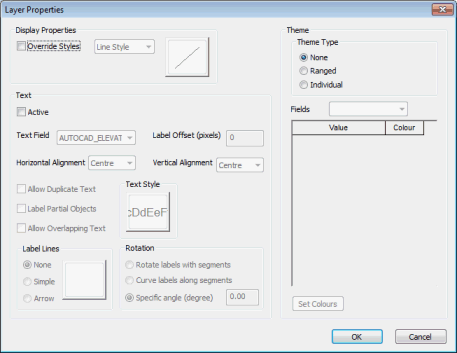

MapXtreme Layer Properties dialog
Fill
Line/Outline
Marker
The properties available for editing will depend on the type of objects in the layer. Colors, patterns, line widths, symbols and symbol sizes can be edited.
Text
Text associated with layer objects can be displayed by checking the Active box. Edit the text appearance using the dropdown boxes.
Check the Draw Features box to make layer objects visible.
Check the Spline text box to display text at the orientation saved in the layer file (text will displayed horizontally if this box is unchecked).
Theme
There are three options for displaying a Theme:
None
Do not display theme
Ranged
Suitable for fields with continually variable values.
Layer objects are displayed using different colors relating to a series of ranged values.
Select the layer field containing the values to be used from the Fields drop down list.
Use the Number of Classes spin control to select the number of ranges required.
Either fill in the values in the Value column manually, or click the Scale Now button to set these automatically.
Select a Start and End color from the Color Ramp. Intermediate colors will be set automatically as a series of gradations between the Start and End color.

MapXtreme
Display Properties
Use to define how the objects in the layer are drawn.
Text
Text associated with layer objects can be displayed by checking the Active box. Edit the text appearance using the drop down boxes. It is possible to add label lines or arrows (Label lines section and to rotate labels (Rotation section).
Theme
None
Ranged
Individual
Suitable for fields with a small number of discrete values.
Layer objects are displayed using different colors relating to individual values in the layer field selected from the Fields drop down list.
