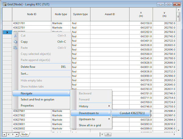

On a Grid
To move to an adjacent or associated object from a Grid Window
  1. Right-click on the row for the current object
  2. On the popup menu, open the Navigate submenu and choose one of the available options. InfoWorks ICM only displays valid options, and all the adjacent or related objects are named
  3. InfoWorks ICM will open a new window if necessary, display the correct view, and set the focus to the correct row for the related object
Example below, taken from InfoWorks ICM.
Example

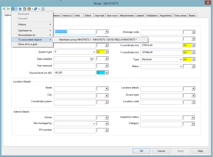

On a Property Sheet
To move to an adjacent or related object from a property sheet
  1. Click on the Navigate button on the toolbar
  2. On the dropdown menu, choose one of the available options. InfoWorks ICM only displays valid options, and all the adjacent or related objects are named
  3. InfoWorks ICM closes the current property sheet, asking you if you want to save changes if appropriate. The property sheet for the related object is then displayed
Example below, taken from InfoAsset Manager.
Example
