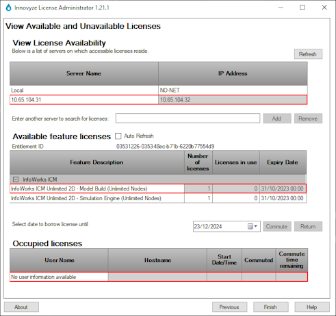

Innovyze offer subscription based Thales licences for InfoWorks ICM and ICMLive Configuration Manager.
These licences are simple to install, and additional users, software or features can be added to the licence remotely with little user interaction. You can also see who is running what using the Innovyze License Administrator (ILA), an example of which is shown below:
This type of licence allows the applicable software to run on your PC or network or remotely. An entitlement ID (EID) is provided by us, which your system administrator, or a user with similar privileges, uses to set up the license on a PC or network server using the ILA.
The ILA is automatically installed when the Innovyze version of InfoWorks ICM or ICMLive Configuration Manager is installed.
