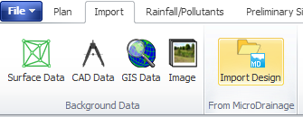

Import Design
MicroDrainage files can be imported into InfoDrainage by clicking the Import Design button.
Importing MicroDrainage Files

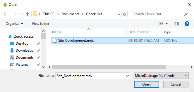

  1. In the Import ribbon, click the Import Design button
  2. Select the MicroDrainage (*.mdx) file that you want to import.
  3. Save the file in a desired location and give it a file name. The application will save the file as an InfoDrainage file (*.iddx).
  4. Click Save.
  5. Review the Import Warnings and then click OK.
