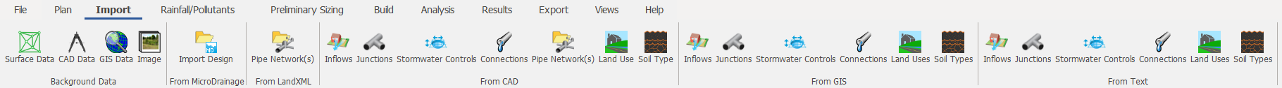

Import Ribbon
The Import ribbon allows you to load information from file as either background data or actual design information.
Note: For a Sanitary phase importing Stormwater Control is not available.
Background Data
Surface Data - Allows you to import and specify terrain information.
CAD Data - Allows you to import CAD Data as the background data.
GIS Data - Allows you to import GIS Data as the background data.
Images - Allows you to import background images.
From MicroDrainage
Import Design  - Allows you to import a MicroDrainage file.
From LandXML
Import Pipe Network - Allows you to import a pipe network from a LandXML file.
From CAD
Inflows – Allows you to import Inflows using the CAD Import wizard.
Junctions – Allows you to import Junctions using the CAD Import wizard.
Stormwater Controls – Allows you to import Stormwater Controls using the CAD Import wizard.
Connections – Allows you to import Connections using the CAD Import wizard.
Pipe Networks – Allows you to import Pipe Networks using the CAD Import wizard.
Land Uses - Allows you to import Land Uses using the CAD Import wizard.
Soil Types - Allows you to import Soil Types using the CAD Import wizard.
From GIS
Inflows – Allows you to import Inflows using the GIS Import wizard.
Junctions – Allows you to import Junctions using the GIS Import wizard.
Stormwater Controls – Allows you to import Stormwater Controls using the GIS Import wizard.
Connections – Allows you to import Connections using the GIS Import wizard.
Land Uses - Allows you to import Land Uses using the GIS Import wizard.
Soil Types - Allows you to import Soil Types using the GIS Import wizard.
From Text
Inflows – Allows you to import Inflows using the CSV Import wizard.
Junctions – Allows you to import Junctions using the CSV Import wizard.
Stormwater Controls – Allows you to import Stormwater Controls using the CSV Import wizard.
Connections – Allows you to import Connections using the CSV Import wizard.
Land Uses - Allows you to import Land Uses using the CSV Import wizard.
Soil Types - Allows you to import Soil Types using the CSV Import wizard.
