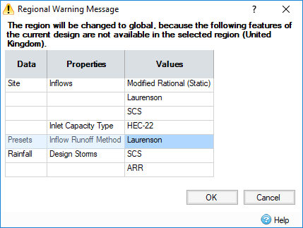

The following actions can create a scenario where an attempt to load values restricted for a region is made:
If one of these actions does result in attempting to load values restricted to the region, the following warning message will appear:
This warning provides a brief description of the issue, including the current region, followed by a table that enumerates all issues. The following columns are shown in the error form:
If you click OK, the warning message will set the region to global. If you click Cancel, the action will be terminated. The undo/redo does not allow the option to cancel.
