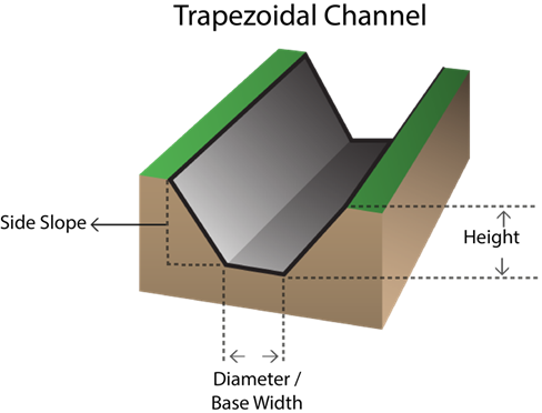

Trapezoidal Channel is an open channel with a trapezoidal cross section where both sides have the same slope. The flow routing through a Channel Connection is described in
Analysis of Junctions and Connections.
Parameters to specify:
Length, Slope, either Manning's n or Colebrook-White Roughness, Diameter/Base Width, Height, Side Slope, see
