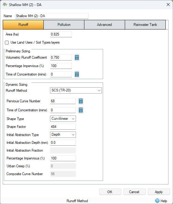

Pervious Curve Number - The runoff CN for the pervious fraction of the Catchment, as described in NEH-4 Chapter 9 and referenced in TR-55. Typical values vary from 20 for regions with high infiltration and interception capacities to 98 for impervious areas. It is a dimensionless number depending on hydrologic soil group, cover type, treatment, hydrological condition, and antecedent moisture conditions. This number has a valid range from 0 to 100 with typical values from 60 to 90 and 98 for impervious surfaces.
When the Use Land Uses/Soil Types layers box is checked, the Pervious Curve Number is calculated from weighted averages of Land Uses and Soil Types.
Pervious and Impervious Curve Number
The Pervious CN characterizes the fraction of the Catchment that is not impervious (area derived from the Percentage Impervious value). The impervious fraction of the Catchment is assigned a default CN of 98.
The Curve Number Calculator can be used when the Use Land Uses/Soil Types layers box is unchecked. The calculator can be accessed using the button to the right of the field. This provides a quick and easy way to select the appropriate CN.

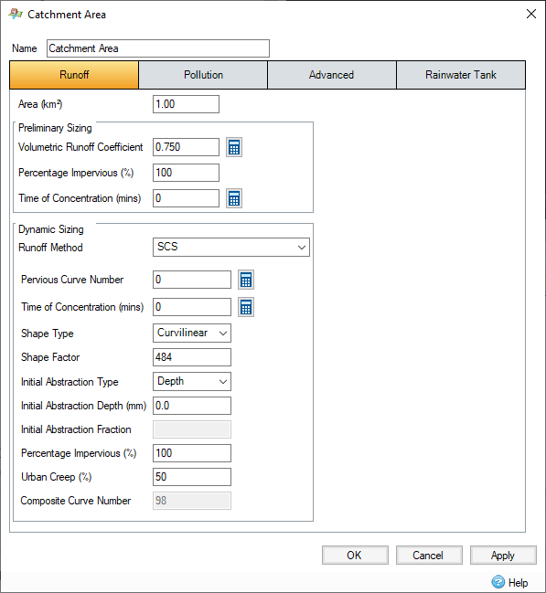

Initial Abstraction - Initial abstraction, Ia, includes interception, infiltration, and surface storage that occur before runoff begins. The maximum potential retention after runoff starts (S) is derived from CN and is used in the standard SCS runoff equation.
The initial abstraction from the precipitation may be represented as an absolute number, that is the total depth of precipitation that is less (in mm or inches) or as a fraction of the amount of precipitation (between 0 to 1). Although it was found to be highly variable for many small agricultural watersheds, TR-55 suggests calculating Ia using the following empirical equation:
Ia = 0.2 × S
where:
S = (1000/CN)-10
S is the potential maximum retention
Percent Impervious - Pervious portion of the Inflow area. When the Use Land Uses/Soil Types layers box is checked, the Percentage Impervious is calculated from weighted averages of Land Uses.
Composite Curve Number - The weighted CN used by the simulation. It is calculated as follows:
CN = (PIMP / 100 * 98) + ((1 - (PIMP / 100)) * PACN)
where:
PIMP = Percent Impervious
PACN = Pervious Area Curve Number
Urban Creep - This scales the impermeable area by the amount specified. This can be used to take the increase of urban areas, or other factors into account. This value is only enabled (and used) when the analysis creep of the Analysis Criteria is set to "Use Catchment Areas".
