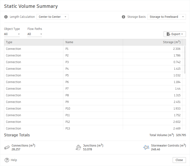

Static Volume Summary
The Static Volume Summary shows a summary of the available volume of each Connection, Junction, and Stormwater Control in the current phase.
A table provides the storage per item, and a totals section provides the total storage as a whole and separated per object type.
Length Calculation - Sets how connections lengths are measured when calculating connection storage volumes. This affects connections storage only.
Storage basis - Sets the design level used when calculating storage volumes for stormwater controls. Connections and junctions storage volumes are not affected.
Object Type - Filter the results in the table and totals section by type of object.
Flow Paths - Filter the results in the table and totals section to include only items within a selected flow path.
Export - Export the table to .csv or .xlsx formats, as well as print the table, including to pdf.
