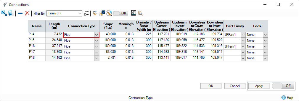

Connections are links between two elements of the site. They allow a Connection Type to be specified, which will impact the Time of Travel along the Connection and therefore impact the analysis.
By default the connections will sync with their connected Manholes to match Invert Elevations.
The flow routing calculations done during the Analysis are described in Analysis of Junctions and Connections.
The connections form allows all of the available connections in the phase to be viewed as a table. The spreadsheet then allows the Connection Type and other physical dimensions to be adjusted as required.
The columns displayed are effected by the Connection Types shown and can also be filtered using the Spreadsheet Preferences.

The Filter By drop-down list allows the connections shown to be filtered:
Fields can be turned on or off using the Spreadsheet Preferences form, which is accessed from the toolbar at the top of the form. The full set of columns available on both the Input and the Results spreadsheet are shown and can be turned on or off using the check boxes. These settings will be remembered between sessions.
