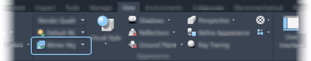

Sets the color scheme for the graphics window, appearance of the background, and optional background image.
What's New: 2021, 2021.1, 2025, 2026, 2027.1
On the Ribbon
View tab
Appearance panel

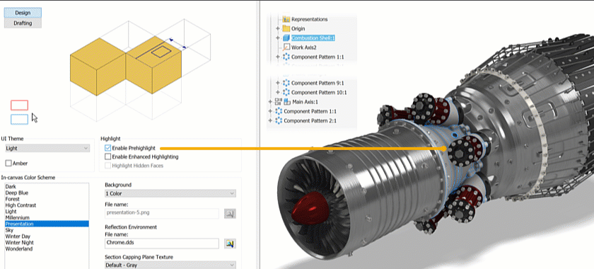

Displays the effect of the color scheme in either the design or the drafting environment. Click Design or Drafting to view the effect of the active color scheme in the view box.
Controls the color of the application icons, window frame, background (default), property panels, and dialogs. Select a user interface theme from the list of available themes.
Choose the Dark theme to have icons lying on a dark gray background.
Choose the Light theme to have icons lying on a white background.
Check this option to use legacy icon colors. You must restart Inventor to update the browser icons.
Sets the object selection behavior.
Objects highlight when the cursor moves over them, helps you to know what you are selecting. Activated by default. In the assembly and weldment environments, when turned off, prehighlighting does not show during component or part selection priority.
Does not affect Select Other, which always shows pre-highlighting.
Also available on the Select pull-down menu on the Quick Access toolbar.
Shows the pre-highlighting or highlighting of assembly components through other components. Highlighting displays when a component or constraint is either highlighted or selected.
Enhances selection highlight to include hidden faces and outlines the selection with a thin contrasting line making selections easier to see.
Lists the available color schemes. Click to select from the available schemes. The view box displays the result of your selection.
Provides access to the Color Scheme editor where you can customize the color schemes of the graphical elements used in Inventor.
