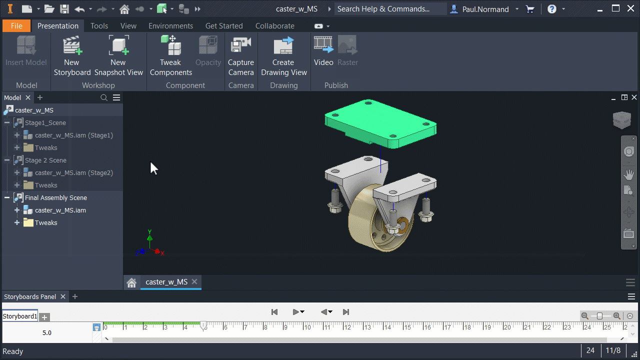

Model States in presentations
Like drawings and other assemblies, presentations use specified Model States.
In the assembly, create a model state entry and save the file. In a new presentation file, use Insert Model and browse to the appropriate assembly. Use Options to specify the appropriate model state.
Further, a presentation updates to reflect changes in the model state. For example, if you add tweaks in a presentation, and then edit the model state in the assembly to suppress more parts, when you return to the presentation, it shows the new state. If parts were deleted that participated in a tweak, the tweaks are deleted.
Note: A Substitute model state is a single part and cannot be exploded.
