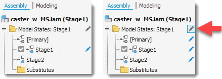

Edit Scope
The following settings determine how Model States, iParts and iAssemblies react to edits. All members respond to edits when Edit Factory Scope is enabled. Only the active member responds to edits when Edit Member Scope is enabled. To change the scope settings:
Note: Delete is a global operation and ignores the Edit Member Scope setting. To remove a feature or component from participating in the active member, enable Edit Member Scope and edit the table.
To remove members from participation:
You can also change the scope settings in the browser. Click Toggle Edit Scope to toggle between Edit Member Scope and Edit Factory Scope.
Edit Member Scope applies edits to the active member. Edit Factory Scope applies edits to all members. In the following image, Edit Member Scope is enabled on the left, and Edit Factory Scope is enabled on the right.

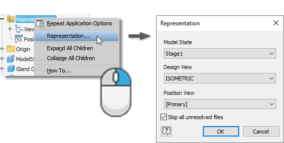

Representations
Use representations to maintain a group of saved states and attributes for a document.
Tip: Right-click the Representations folder in the browser to set the desired representations.
Tip: Hover a representations folder in the browser to display the quick-create + button. Click + to create a new representation without opening the context menu. The + button creates:
