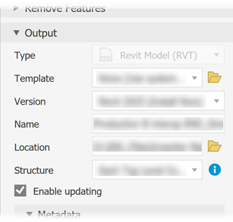

  7. Output provides options to define the output type and structure for your intended use.
    Output group
    • Type displays the output type is a Revit model (RVT).
    • Template: sets the Revit template file to use for the new rvt file output. Navigate to and select the desired template. If no template is selected, the system default template is used.

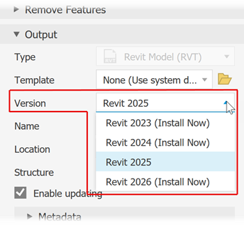

    • Version: Select the Revit version (2023 and newer) that you want to output to.
      Note: If the matching version of the Revit Core Engine (RCE) is not installed, you will be prompted to install it. During the installation you can continue in other Inventor work. Once the installation is done, you can again continue with the Simplify command.
      Important: If updating a previous RVT output and using a newer version from the list, the RVT output is migrated to the newer version and can only be opened in the newer Revit version or a later one.
    • Name: Use the default file name or specify your own. The default uses the assembly name and adds a suffix.
    • Location: Sets the location of the exported file.
      Note: Inventor stores the exported file location. If the exported file is subsequently moved this will inhibit Inventor's ability to make associative updates later.
    • Structure
      • All in One Element: Outputs a Revit model with one element representing the simplified assembly. The Include Properties selections are not supported for this output option.
      • Each Top Level Component: Outputs a Revit model with multiple elements representing the first level components of the simplified model.
      • Parts Only: Outputs a Revit model with multiple elements representing each individual part in the simplified model.
      • Enable updating: creates a browser node that enables you to edit the simplification and update the exported RVT. This option is selected as a default. If deselected, no browser node is created and export criteria is not retained. Any updates to the exported file require exporting the model again.
        Note: Select Enable updating if the Inventor design is expected to change as the exported RVT file can be updated by editing the simplified model.

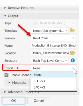

      • Export IFC (available when Version is set to Revit 2026): Outputs the selected IFC version file with the exported RVT file. The files have the same name but not the same file type. The default setting is None.
        Export IFC

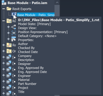

You can view the exported properties by pausing the cursor over the browser node of the exported file.
view exported properties
