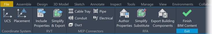

In the ribbon, click Environments BIM Content to enter the environment.
BIM Content Environment
You can pause the cursor over each icon to learn more about the command. When the extended tooltip displays, use F1 to go access the learning content for the command.

  1. Create a fully detailed, configurable Inventor product model.
  2. In the ribbon, click Environments BIM Content to enter the environment.
  3. Orient the model for use in Revit using the tools in the Coordinate System panel.
    • UCS to create a user coordinate system specific to your design.
    • Placement to define the model orientation and insertion point that is used in Revit.
  4. For RVT output, use the tools in the RVT panel.
    • Use Include Properties to selectively share Inventor properties and add BIM metadata in Revit. Select the properties you want to include in the RVT file.
      • Upon export, all components have the iProperty Revit Category (iProperties Project tab), which defaults to <None>. In Include Properties, you can select a Default (Revit) Category to apply to all components that have the iProperty Revit Category set to <None>.
    • Use Simplify & Export to output to RVT format.
  5. For RFA output use the MEP Connectors and the RFA panel tools to prepare the model.
    • Use the MEP connectors to add needed BIM connectors to the model.

    • Use Author Properties to:
      • Add BIM metadata for your product. Inventor provides access to:
        • A searchable Revit categories list so you can specify your product in Revit terms.
        • Model Properties you may want to export.
          • Recommended: Create an iProperty named "RevitFamilyTypeName". The value will be used as the family type name in Revit. The value of this property can be a static string or can be programmatically assigned using an iLogic rule to make it unique for the supplied parameter values.
        • Specify the model orientation and insertion point.
        • Click OK or Apply if more edits are needed.
    • Use the Simplify Substitute command to create a substitute model that contains only the content to be visible in the exported BIM model.
      You should exclude components that:
      • Are not visible to the consumer, that is, the Revit user, the architect, etc.
      • Represent intellectual property
      • Do not significantly contribute to the visual presentation, e.g. small parts like fasteners and others not necessary to indicate size/function/etc.
      • Optionally, you can simplify the remaining components by removing features and internal voids.
    • Use Export Building Components to create the RFA file. You can also create .IFC and .ADSK files for the component.
