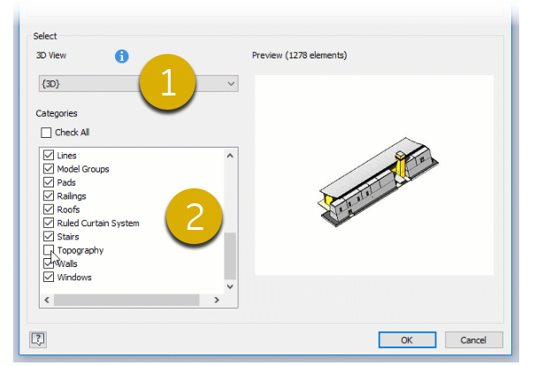

You control the number of elements by selecting an appropriate Revit 3D view during the import process.
Views and Categories
  1. Revit 3D views are created by the Revit user to satisfy viewing requirements and needs. They cannot be defined or have their definition modified from within Inventor. You choose which view to import from the available views. Only visible elements are imported.
  2. Once the view is selected, you can further refine what is imported using the Category chooser. Select only the categories you require as references. The Inventor Import dialog displays the number of visible elements for the selected view but this number provides only a rough idea as to whether or not this will be small or large in Inventor.
