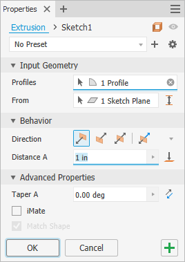

  1. On the ribbon, click 3D Model tab Create panel Extrude .
    If there is only one profile in the sketch, it is selected automatically. Otherwise, select a sketch profile.
  2. By default Extrude creates a solid body from an open or closed profile. You can also extrude a sketch as a surface body from an open or closed profile.
    At the top of the property panel is the breadcrumb. To the right of the breadcrumb select Surface mode . The selection determines the options presented in the property panel. The Surface mode state (ON/OFF) is saved with presets.
    Note: Surfaces function as a construction surface on which to terminate other features, or a split tool to create a split part, or split a part into multiple bodies. Surface selection is not available for assembly extrusions or primitives.
  3. Specify the Input Geometry. You can use window select to quickly select multiple closed profiles within the same sketch.
    Note: Use the From and To options to get the same result as the Distance from Face and Between methods used in prior releases.
    Important: During feature preview visible sketch dimensions can be edited without entering the sketch environment.

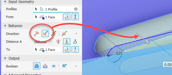

    • From - As the default, the extrusion starts from the sketch plane. To change the selection, in the From field, click the 'x' to clear the selection and choose a different starting plane. Work planes, sketch planes, and planar faces are valid input.
      • Between - use when extruding a shape between two faces. Select From and To faces, then select the Output type. The sketch doesn't have to be on either face.
        Note: If the solution isn't what you were looking for with the Default direction, click Flipped direction and toggle Alternate Solution to see additional solutions.
      • Extend face to end feature - automatically activates when the From selection does not intersect the extruded profile. You can also manually turn on or off the option. To turn the option off, click . The following is an example for how From and To are used together:
  4. Specify the Behavior parameters, first choosing from the available options:
    • Direction: Default - Extrudes in one direction only. The extrusion end face is parallel to the sketch plane.
    • Flipped Direction - Extrudes in the direction opposite of Direction.
    • Symmetric - Extrudes in opposite directions from the sketch plane, using half the specified Distance A value in each direction.
    • Asymmetric - Extrudes in opposite directions from the sketch plane using two values, Distance A and Distance B. Enter a value for each distance. Click to invert the extrude direction using the specified values.
    • Distance A - specifies the depth of extrusion between start and end planes. For a base feature, shows negative or positive distance of extruded profile or entered value. Dragging the manipulator will modify the value.
    • Distance B - specifies the depth in the secondary direction. Displays when Asymmetric is selected.
    • Through All - extrudes the profile through all features and sketches in the specified direction. Dragging the edge of the profile flips the extrusion to either side of the sketch plane. The Join operation is not available.

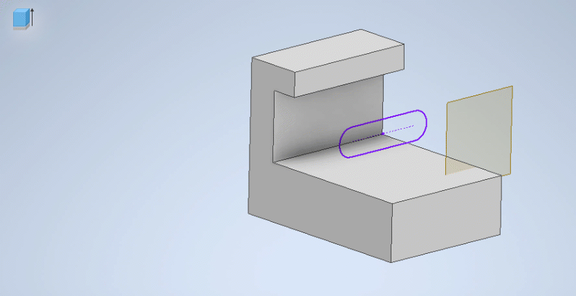

Create an extrusion terminating at a distance from a face
The profile sketch does not have to lie on the originating plane for the extrusion.
  1. Click 3D Model tab Create panel Extrude .
  2. If there is only one profile in the sketch, it is selected automatically. Otherwise, select a sketch profile.
  3. Select the face, work plane, or surface from which to start the extrusion. The option Extend face to end feature automatically activates when the From selection does not intersect the extruded profile. You can manually change the option.
  4. Specify the Behavior options, which could be direction and distance, to another face, and so on. Based on the selection the Terminate feature by extending the face option may be turned on. If the solution is ambiguous, such as when terminating to a curved surface, try applying the Alternate Solution option.
    Note: When working with a multi-body solid, you will need to specify the extrusion as part of another body by activating the Solid(s) selector and clicking the desired body or as a new body.
  5. Click OK or (Create new feature) to continue defining extruded features.
