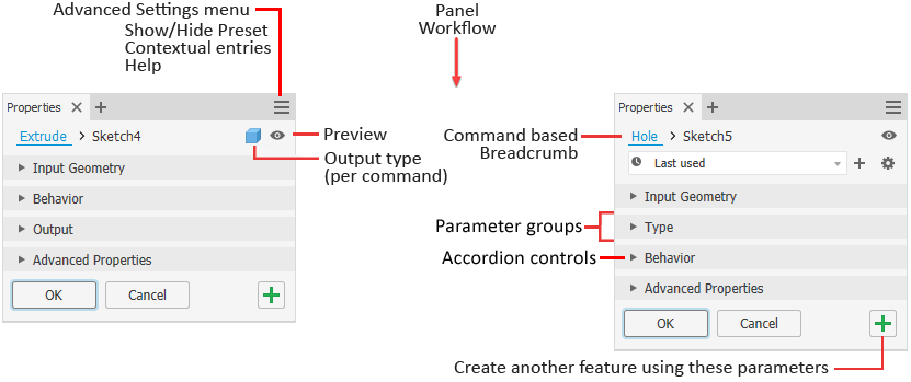

Property Panels provide contextual access to parameters used for creating and editing features.
The property panel floats above the graphic area and, initially, appears in the upper left of the graphics area. Panels can be resized, combined with the Model browser, moved to another location, and even to a secondary monitor. Property Panels use parameter groups with an accordion control instead of tabs.
Workflow - the property panel workflow is from top to bottom. Any property you set or change can affect the properties in sections below it. A property does not affect the properties in preceding sections.
Orange dots - these appear when Inventor is newly installed. They highlight seldom used settings, command and feature productivity options, and new command options. Display options are located in the Get Started
New Features panel, click Highlight New. See To Work with New and Updated Badges.
Breadcrumb - quickly switch from editing the feature to editing the associated sketch. Rename the feature or sketch right from the breadcrumb.
Preview - located to the right of the breadcrumb, Preview toggles the feature preview visibility when editing the feature or sketch. During sketch editing, selected regions or loops preview in wireframe. Toggle the option to hide the preview.
Presets - use presets to create reusable feature definitions. For more on Presets, see To Work with Presets.
Value edits - shortcut keys to navigate the panel, colored text alerts to value health:
Accordion control - parameter groups can be expanded to expose parameters for editing or collapsed to hide seldom used parameters.
Advanced Settings menu - the drop down provides access to property panel state and other advanced settings. The menu adjusts based on the active command. Some settings are:
Edit fields cross-highlight between the property panel and the in-canvas edit controls. This default behavior can be overridden by using the Advanced Settings option Single ENTER to finish command.
Apply and create new - click to create the feature using the current settings and begin creating another feature using the same settings. You can change any settings, as needed, then create another feature.
Docking - the property panel and its tool palette can be docked in any Inventor application graphics window, within the browser space, or remain floating whether over the application or somewhere on the desktop. This allows you to position the panel or browser wherever it is convenient for you. When docking the panel to a window frame, the target frame edge highlights to confirm where the docking will occur. The next time the command is initiated, it starts in the docked location. If the window was closed prior to initiating the command, the property panel docks to the main app window.
Display - panels remember their most recent display state and use that when next visited.
Some commands include a tool palette. Tool palettes expose options useful for the command during its operation. Tool palettes are docked to the property panel by default.

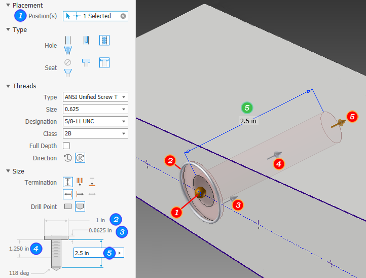

When creating or editing features you can use the edit fields in the Property panel, the in-canvas edit fields, or the feature manipulators to modify values.
The following example uses the Hole feature to illustrate the various parameter value access points.

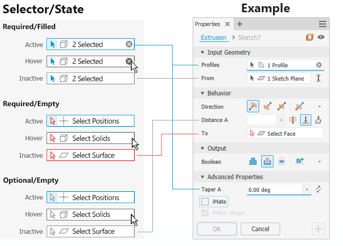

The property panel selectors display their states using colors. Click in a selector field to activate it. The following image shows the states and ties them to an example.
When a selection is made, the selector field displays the number of items selected and an 'X' at the right end of the field. To clear the selection set, click the 'X', then, make your next selections.
If the required inputs are not satisfied, the marking menu displays either a disabled OK button or a Continue button in the 3 o'clock position to alert you of the need to complete the definition.
