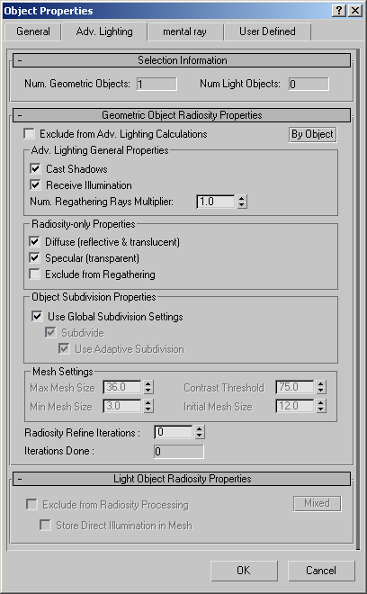

Interface: INodeGIProperties
This Node Interface exposes the node’s Global Illumination Properties. These properties correspond to the UI controls found in the "Adv. Lighting" tab of the Object Properties dialog in 3ds Max 5 and higher.
Properties
<node>.isGIExcluded : boolean : Read|Write
Corresponds to the Exclude from Radiosity Processing checkbox in the Object Properties > Adv. Lighting tab
Note: Since hidden objects are NEVER considered by the radiosity processing, setting .isGIExcluded to false for hidden objects will have no practical effect on them - they will NOT be processed unless unhidden!
<node>.GIByLayer : boolean : Read|Write
Corresponds to the By Layer / By Object checkbutton in the Object Properties > Adv. Lighting tab
Adv.Lighting General Properties
<node>.isGIOccluder : boolean : Read|Write
Corresponds to the Cast Shadows checkbox in the Object Properties > Adv. Lighting tab
<node>.isGIReceiver : boolean : Read|Write
Corresponds to the Receive Illumination checkbox in the Object Properties > Adv. Lighting tab
<node>.GIRayMult : float : Read|Write
Corresponds to the Num. Regathering Rays Multiplier value in the Object Properties > Adv. Lighting tab
Radiosity-only Properties
<node>.isGIDiffuse : boolean : Read|Write
Corresponds to the Diffuse (reflective & translucent) checkbox in the Object Properties > Adv. Lighting tab
<node>.isGISpecular : boolean : Read|Write
Corresponds to the Specular (reflective & translucent) checkbox in the Object Properties > Adv. Lighting tab
<node>.isGIExcludedFromRegather : boolean : Read|Write
Corresponds to the Exclude from Regathering checkbox in the Object Properties > Adv. Lighting tab
Object Subdivision Settings
<node>.GIUseGlobalMeshing : boolean : Read|Write
Corresponds to the Use Global Subdivision Settings checkbox in the Object Properties > Adv. Lighting tab
<node>.GIMeshingEnabled : boolean : Read|Write
Corresponds to the Subdivide checkbox in the Object Properties > Adv. Lighting tab
<node>.GIUseAdaptiveSubdivision : boolean : Read|Write
Corresponds to the Use Adaptive Subdivision checkbox in the Object Properties > Adv. Lighting tab. Available in 3ds Max 8 and higher.
Mesh Settings
<node>.GIMeshSize : worldUnits : Read|Write|Validated by Range: 0.01 to 1e+009
Corresponds to the Max.Mesh Size value in the Object Properties > Adv. Lighting tab
<node>.GIMinMeshSize : float : Read|Write
Corresponds to the Min.Mesh Size value in the Object Properties > Adv. Lighting tab. Available in 3ds Max 8 and higher.
<node>.GIContrastThreshold : float : Read|Write
Corresponds to the Contrast Threshold value in the Object Properties > Adv. Lighting tab. Available in 3ds Max 8 and higher.
<node>.GIInitialMeshSize : float : Read|Write
Corresponds to the Initial Mesh Size value in the Object Properties > Adv. Lighting tab. Available in 3ds Max 8 and higher.
<node>.nbGIRefineSteps : integer : Read|Write|Validated by Range: 0 to 65535
Corresponds to the Refine Iterations value in the Object Properties > Adv. Lighting tab
<node>.nbGIRefineStepsDone : integer : Read|Write|Validated by Range: 0 to 65535
Corresponds to the Iterations Done value in the Object Properties > Adv. Lighting tab
Light Object Radiosity Properties
<node>.storeIllumToMesh : boolean : Read|Write
Corresponds to the Store Direct Illumination in Mesh checkbox in the Object Properties > Adv. Lighting tab
