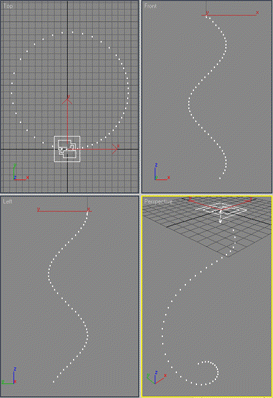

The following example shows the default Every Step Update script with detailed comments.

The script modifies particle speed and direction, causing particles to follow a spiral path:
EXAMPLE
