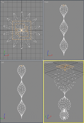

The default script modifies particle speed and direction, causing particles to follow a bulb-shaped path:
EXAMPLE

           --Get the age of the particle, multiply by 5 and use as angle
           --to define the particle speed
           --Decreasing the constant 5 will slow down the rotation
           --Increasing the constant will speed up the rotation
           age = 5 * pf_node_current.particleAge
           --Calculate a factor variable based on the particle age
           --This variable will define the radius of the bulb and will vary
           --thanks to the sine of the age over time.
           --Change the constant 20 to change the radius.
           factor = 20 * (sin(2 * age) + 1)
           --Finally, calculate and set the particle position
           --using the factor as Radius and the particle index as Angle
           --in the function of the circle. The position of the node has to be
           --added to move the particles to the origin of the Source.
           --Info: In general, a circle can be drawn using an Angle
           --going from 0 to 2*Pi and the following functions for X and Y:
           --X = CenterX+Radius*Cos(Angle)
           --Y = CenterY+Radius*Sin(Angle)
           --In our case, CenterX and CenterY are 0, Radius is set to factor,
           --and Angle is based on the particle index multiplied by 77.
           --The Z position is based on the age.
           pf_node_current.particlePosition = [factor * cos(77 * i), factor * sin(77 * i), -age] + pf_node_current.pos
