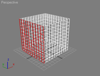

EXAMPLE
   --Create a box with 10x10x10 segments:
   b = box width:100 length:100 height:100 heightsegs:10 widthsegs:10 lengthsegs:10
   ep = Edit_Poly()--create an Edit_Poly modifier
   addModifier b ep--add the Edit_Poly modifier to the box
   max modify mode--switch to Modify tab of Command panel
   modPanel.setCurrentObject ep--set the Edit_Poly as the current level
   subObjectLevel = 3--switch to Border level
   --Now print the selection level using stand-alone interface access:
   format"Selection Level Is: %\n"(EditPolyMod.GetEPolySelLevel ep)
   --Now print the Mesh selection level using interface access via the modifier:
   format"Mesh Selection Level Is: %\n"(ep.EditPolyMod.GetMeshSelLevel())
   subObjectLevel = 4--switch to Face level
   --Select a whole side of the box- last 100 polygons. Call the method
   --without explicitly specifying the EditPolyMod interface - still works:
   ep.Select #Face #{501..600}
   ep.convertSelection #Face #Edge--convert the face selection to edge selection
   subObjectLevel = 2--switch to edge mode to see the result
OUTPUT:
   $Box:Box01 @ [0.000000,0.000000,0.000000]
   Edit_Poly:Edit Poly
   OK
   OK
   OK
   3
   Selection Level Is: #Border
   OK
   Mesh Selection Level Is: #edge
   OK
   4
   true
   220
   2

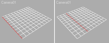

EXAMPLE
   p = plane width:100 length:100 widthsegs:10 lengthsegs:10--create a plane
   addModifier p ep--add modifier to the plane
   max modify mode--switch to modify mode
   select p--select theplane
   subObjectLevel = 2--switch to Edge mode
   ep.select #Edge #{1}--select first edge
   ep.ButtonOp #SelectEdgeLoop--select Loop using the first edge
   ep.RingSelect 3 true false--shift the selection by 3
Shifting one or all edge loops by three using all possible argument combinations:
MoveOnly Add Result:
true false
true false
true true
true true
false true
false true
false false
false false

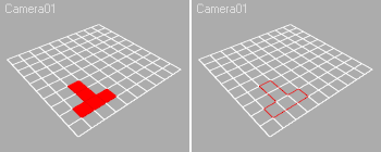

EXAMPLE
   subObjectLevel = 4--switch to face SO level
   editPolyMod.select ep #Face #{12,13,14,23,33}--select some faces
   editPolyMod.ConvertSelectionToBorder ep #Face #Edge--convert to edge selection
   subObjectLevel = 2--switch toedgeSO levelto see the result:
