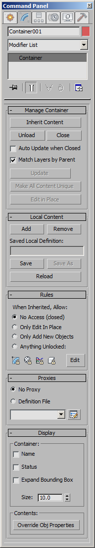

Local Content (Left) and Inherited Content (Right) - Quick Navigation

<Container>.autoUpdateClosed BooleanClass default: false -- boolean; AutoUpdate_when_Closed
Get/set whether to update the content automatically when the container is closed.
Corresponds to the "Auto Update when Closed" checkbox in the Container's UI.
<Container>.duplicateMatchingLayers     BooleanClass    default: true   --  boolean; Match_Layers_by_Parent
Get/set the state of the "Match Layers by Parent" checkbox.
Local Content Properties
<Container>.localDefinitionFilenameString default: "" -- filename; Local_Definition_Filename
Get/set the "Local Definition" file name.

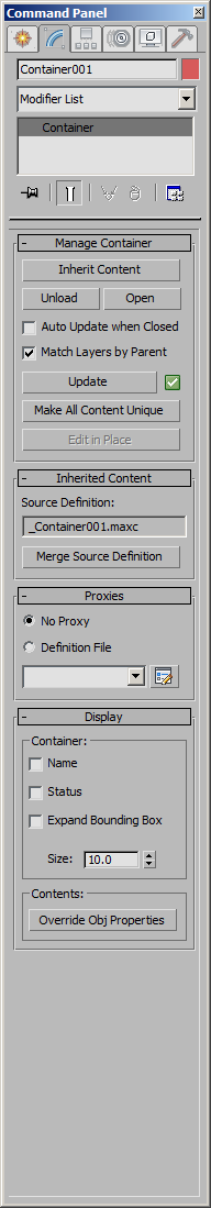

Inherited containers reference a source definition file .If the container is inherited, the name is empty.
Inherited Content Properties
<Container>.sourceDefinitionFilename String default: "" -- filename; Source_Definition_Filename
Get/set the "Source Definition" filename. If the container is local, the name is empty.
Definition files have the format of a 3ds Max scene file, but use a different .MAXC file extension. This is to allow users to distinguish container definitions from regular max scenes when browsing folders and prevent accidental edits of container definitions. It is possible to rename the container definition and open it as a .MAX file.
Inherited containers reference a source definition file.

Proxies Properties
<Container>.alternateDefinitionFilename ArrayParameter default: #() -- filename array; Alternate_Definition_Filename; SubAnim
Get/set the alternate (Proxy) definition filenames list.

Content RulesProperties
The content rules are stored with the .MAXC asset file and control how the content will behave when inherited by a container.
<Container>.allowInPlaceEditing BooleanClass default: false -- boolean; Allow_In_Place_Editing
Get/set the In Place Editing Container Rule.
Corresponds to the state of the "Allow In-Place Editing" checkbox in the Container's UI.

Display- ContainerProperties
<Container>.displayLabel BooleanClass default: false -- boolean; Display_Label
Get/set the state of the Name checkbox. (called "Label" in 3ds Max 2010).
When set to *true* , a text label appears next to the Container to show its Name.

<Container>.updateNeeded BooleanClass default: false -- boolean; Update_Needed
Contains true if the Container needs an update. Reflects the state of the icon next to the Update button.
Read-only.

Display -ContentsProperties
<Container>.overrideNodeProperties BooleanClass default: false -- boolean; Override_Object_Properties
Get/set the state of the "Override Obj Properties" checkbutton.
When set to *true* , the content will display using the Container's display properties including wireframe color, visibility settings, and so on. If the content is set to use properties By Layer, the Container's Layer will be used instead of the content's Layers.
When set to *false* , the content will display using its own display properties.
