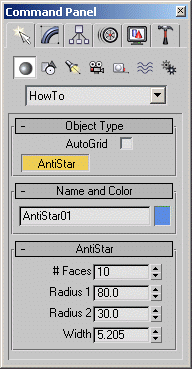

The scripted plug-in stores its parameters in a so-called Parameter Block. The ParamBlock2 format has been introduced in 3ds Max 3 and allows for easy properties and tracks management, automatic animation brackets in the UI, and more. In this case, we will store the same values used in the first mesh script (number of faces, the two radii and the width (offset) value) in the ParamBlock.
All parameters in the block have their counterparts in the plug-ins rollout in the UI. By providing the rollout name, you allow the ParamBlock to establish an automatic connection between the internal values and the UI elements.

rollout params "AntiStar"
spinner num_faces "# Faces" range:[2,100,10] type:#integer
spinner radius1 "Radius 1" range:[0,10000,0]
spinner radius2 "Radius 2" range:[0,10000,0]
spinner width "Width" range:[0,90,1]
Now, you can provide the rollout with UI elements referenced by the Parameter Block. The UI elements can limit the input values using the optional range: parameter, but the default value is taken from the ParamBlock2.

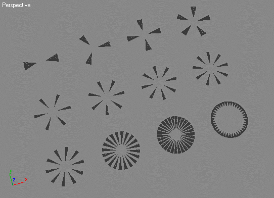

To use the plug-in, click the AntiStar button in the Create panel > Geometry > HowTo. Click in the viewport to define the center, drag to define the outer radius, click and drag again to define the inner radius, and click and drag again to define the width. Click to finish or right-click to cancel.
Play with the controls in the UI under the Modify panel and note how quickly the mesh is updated by the script.
