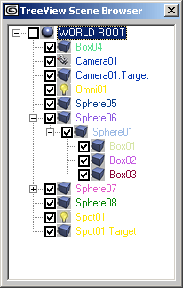

Extend the existing macroScript.
Define a function to grab a single icon from the shipping icon files of 3ds Max
Extend the initTreeView function to generate icons for most object types
Assign an icon to each node created for each scene node
Set the color of each node to the wireframe color of the scene node
Set the checked state of each node to the opposite of the hidden state of the scene node
Enable checkboxes in the TreeView
Define another ActiveX control to hold and manage the icons to be displayed
Add an event handler to hide/unhide objects when the corresponding checkboxes are unchecked/checked

RESULT:

) newNode = tv.Nodes.add theNode.index 4 "" c.name theIcon
Instead of setting the icon index to 0 as we did in Part One, we set the icon to the value defined above...
theNode.sorted = true
We wanted all levels of the hierarchy to be sorted alphabetically.
newNode.checked = not c.isHidden
The checked state of the node will be the inverse of the .isHidden property (which is true when the node is hidden). Since we want to check the box when the node is NOT hidden, we tell exactly this...
newNode.forecolor = color c.wirecolor.b c.wirecolor.g c.wirecolor.r
Since we have complete control over the color of each node in the TreeView, why not grab the color of the wireframe display and assign to the .forecolor property? This gives us a colorful reference to the color of the scene objects!
You could enhance this to grab the diffuse color of the material in the cases where the object has a Standard material assigned, or use the color to represent some other property... In addition, you could also set the .bold property of the TreeView node to true to represent some other property of the 3ds Max objects...
addChildren tv newNode c.children
