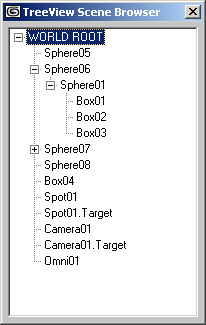

RESULT:

            activeXControl tv "MSComctlLib.TreeCtrl" width:190 height:290 align:#center
