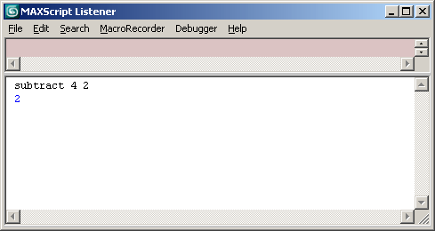

In order to use a function, you simply enter the function name and the values for its variables:
This example uses what are known as positional arguments. When you call the function, you must supply both arguments, and you must supply them in the proper order for the function to execute properly.
