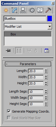

The following lines prepare our box for more complex transformations. They change the number of box segments on all sides, and put a check mark into the Generate Mapping Coords. box in the Parameters rollout:
ENTER THE FOLLOWING FOUR LINES OF CODE:
   mybox.lengthsegs = 10
   mybox.widthsegs = 10
   mybox.heightsegs = 10
   mybox.mapCoords = true
MAXScript has changed the appropriate settings in the Parameters rollout:

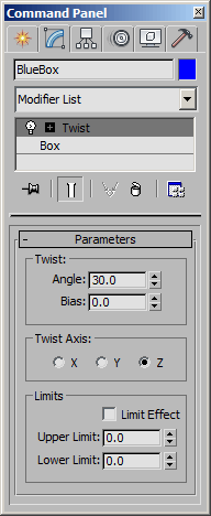

To create a Twist modifier set to 30 degrees and apply it to your box,
ENTER
   addModifier mybox (twist angle:30)
The box in your Perspective viewport is now twisted and the interface shows the new Twist modifier in the modifier stack display, together with its parameters:

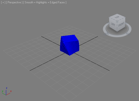

To change the angle of the twist modifier to 60 degrees,
ENTER
   mybox.twist.angle = 60
The twist of your box is now more pronounced and the Angle parameter of the Twist modifier displays the new value:

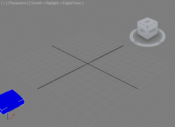

   animate on
       at time 0 (mybox.pos = [-100, 0, 0]; mybox.scale = [1, 1, 0.25])
       at time 100 (mybox.pos = [100, 0, 0]; mybox.scale = [1, 1, 3])
Drag the slider around, and you will see that MAXScript has animated the box, and placed keyframes at 0 and 100.
