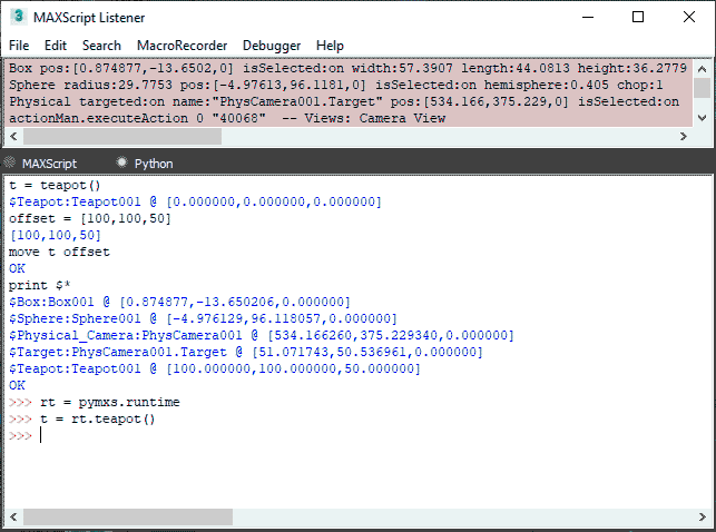

The Listener is divided into two panes: the top (pink) pane is the Macro Recorder pane, and the bottom (white) pane is the output pane.
When the Macro Recorder is enabled, everything recorded is displayed in the Macro Recorder pane.
The output of results from scripts are displayed in the output pane.
The output of code executed in the Macro Recorder pane is always directed to the output pane so as not to clutter the recordings.
Both panes allow you to cut-and-paste, drag-and-drop, edit, select, and execute code.
You can resize the panes by dragging on the split bar between them.
